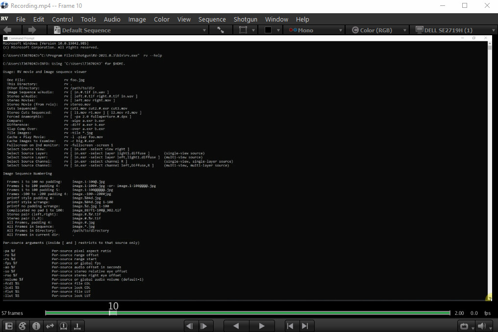

Hi @patrick-hubert-adsk ,
I have recorded it (let me know if you can’t play the video) . The version of RV is RV 2021.0.3 .
Thanks for the video and the added information.
Unfortunately, at this point the only suggestion I have is to try to start RV from a command prompt, with the rv -resetPrefs argument.
But before you do, please check that you can run rv --help and see the help.
I am on a Mac, and I am not sure of the behaviour on a PC.
Have you opened a support ticket ?
-Patrick
Oh no, its not recognizable .
No I didn’t opened support ticket on this issue .
I did have a issue on upgrading from Shotgun Desktop to ShotGrid Desktop (last week ticket) . Up until now there is no reply.
So i guess i try it here , because the respond is much faster
Ah, I see the problem.
You either need the full path of the rv.exe binary or do a cd to that folder.
Can you do a find for rv.exe and then just drag-and-drop the binary into your command-prompt ? This just copy the path to it.
And then do the rv --help
-Patrick
We are making progress,
But rv was meant as an alias to the whole path + exe.
And now, same thing : drag and drop the rv.exe and add -resetPrefs
You full line should be:
"C:\Program Files\Shotgun\RV-2021.0.3\bin\rv.exe" -resetPrefs
-Patrick
