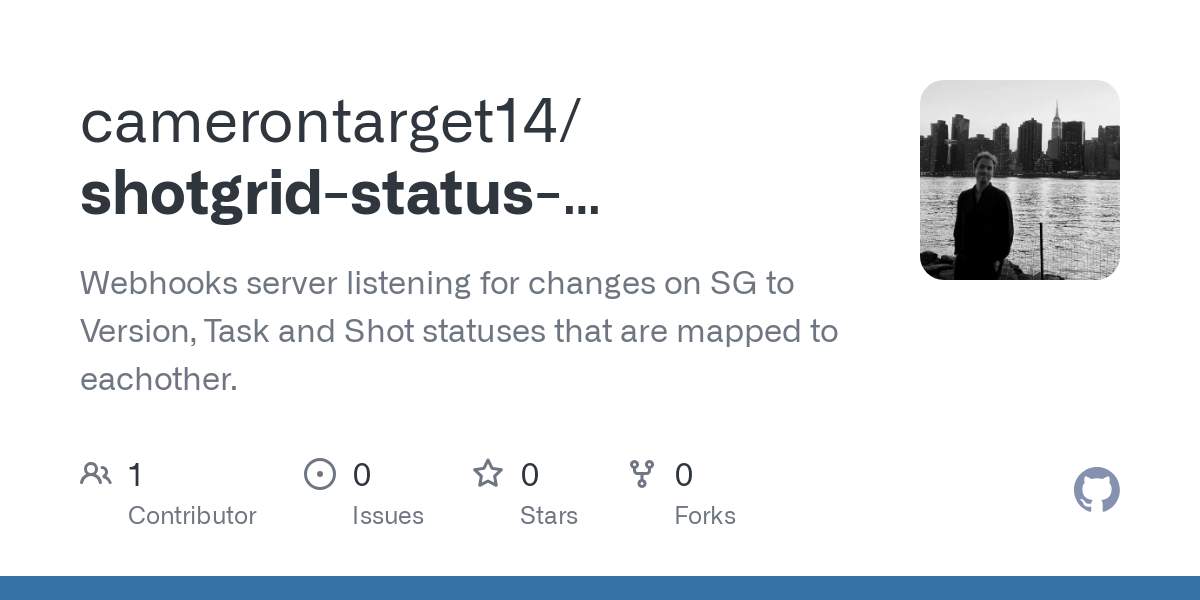

Hi all,
I released an open version for this that we hosted on firebase for SG to reach.
Hope it’s helpful to those looking to map similar status flips!
