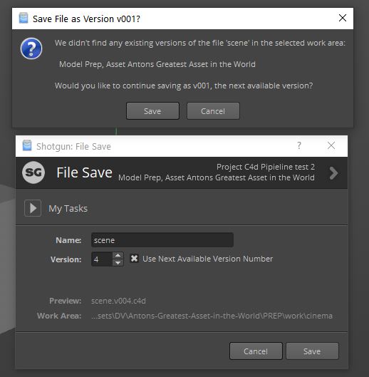

  • Try to save the 3rd version and i get this:
It reads the previous files fine when populating the preview but than when i hit the save it sayt it cant see the files and wants me to start saving again from v001
Any idea where i should start looking?
The fact that it works twice and gets stuck on third attempt is interesting. Possibly also points to a problem. jut i have no idea.
Additional info: trying the same steps with Houdini in the same Shotgun project gives no problems.
Additional Info: Restarting computer didn’t help. But unchecking the the Use Next Available Version Number helped…
