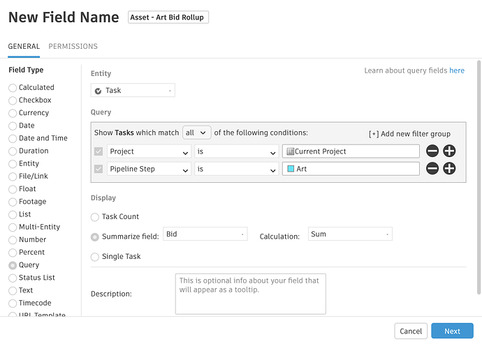

Thanks for the additional context, Meggie! A query field on the Project entity that looks like this may do the trick, then. You’d need one for each Pipeline Step on which you want to report:
You can further tighten the scope of the filter by adding additional conditions (e.g. maybe you need to exclude Tasks which have the status Omit). How many steps do you need to report on?

Roger that. Ya, with the query field approach your Projects would be rows, and the calculated data the columns. I’ll check with the rest of my team and ask them to chime in here if they have some other ideas.
Hi Meggie,
Chatting over options with the team, it sounds like the workflows I described above are currently as far as you can go while still operating within Shotgun. It may be necessary to export your data to excel and use some pivot tables to get what you ultimately need.
