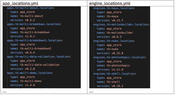

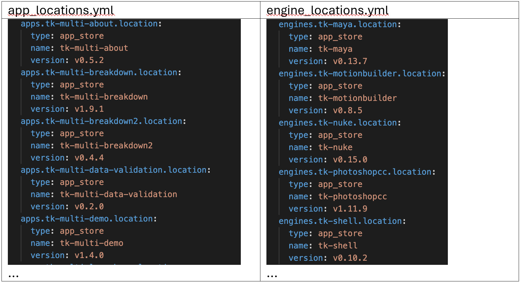

  • To update an engine, find your engine_locations.yml from your configuration. Ie, updating tk-nuke version manually in the engine_locations.yml as indicated in the latest release.
  • For apps, you can also follow the same procedure to apply the updates, by modifying the version for the respective apps in the app_location.yml file within the config folder of your configuration.
