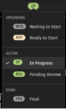

Task status menu
I want to know, how task status widget is implemented in shotgun create?
is it QCombobox or QToolButton ?
reference
Hi @robert,
Most of the things you see in create is HTML based and everything is custom made (except the toolkit python apps and some things requiring high performance). We have an internal react library that give us the power to use the same UI in both Shotgun Create and the modern parts of the Shotgun web app.
Extra:
Qt is used as the backend of the application and the UI is a single page app rendered using QtWebEngine. The communication between the two is done using the chromium IPC version of QtWebChannel.
Kerby
@geffrak
