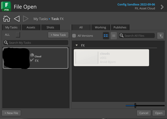

Houdini Toolkit GUI has unreadable colors
I just updated all my Toolkit components, and now the loader in Houdini looks like this, the entries in the list used to have pretty low contrast before as well, but now it’s almost unreadable with light gray on white.
It’s only happening in Houdini, so I’m assuming it picks up the color from Houdini somewhere, so is it something I can easily tweak? Or is it a more fundamental issue with the Houdini integration?

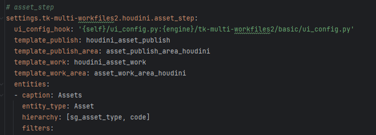

Tweak the config of the workfiles2 app for houdini and add this line:
ui_config_hook: '{self}/ui_config.py:{engine}/tk-multi-workfiles2/basic/ui_config.py'
Thanks! But no success yet. Can you be more specific about the second step, because I’m not sure I did it correctly. Are we talking about env/includes/settings/tk-multi-workfiles2.yml?
Like this (in every Houdini related workfiles config, so .asset_step, .shot_step etc.):
Thanks, that did work for the asset and shot steps once I’ve opened or saved a scene, but it’s still wrong when you’re not in a context yet, i.e. the “Project Environment”, for example when you just open the program from FPT Desktop and go “Open” from the FPT menu.
Seems like I don’t have any Houdini-specific settings for that in my yml. Is there a way to add this hook to the Project environment lever as well? I tried this by looking at other lines in there, but doesn’t seem to work, so maybe there’s another way to get to that Project env?

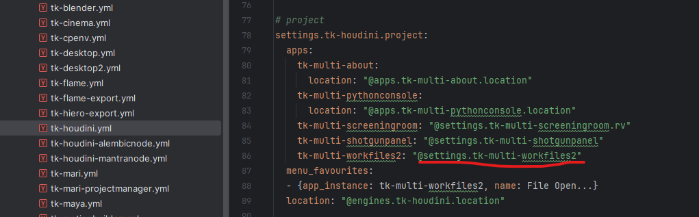

You are on the right track but you now need to reference that new environment setting in your Project step environment for Houdini.
I see, but that line you’ve underlined is already present, should I modify it?
Yes you need to point it to the name of your houdini project config.
tk-multi-workfiles2: "@settings.tk-multi-workfiles2.houdini.project"

The config I use have been kicking around for a while and may not be up to date, but it looks like this, seems the same to me except for the pythonconsole lines:
# project
settings.tk-houdini.project:
  apps:
    tk-multi-about:
      location: "@apps.tk-multi-about.location"
    tk-multi-screeningroom: "@settings.tk-multi-screeningroom.rv"
    tk-multi-shotgunpanel: "@settings.tk-multi-shotgunpanel"
    tk-multi-workfiles2: "@settings.tk-multi-workfiles2"
  menu_favourites:
  - {app_instance: tk-multi-workfiles2, name: File Open...}
  location: "@engines.tk-houdini.location"
