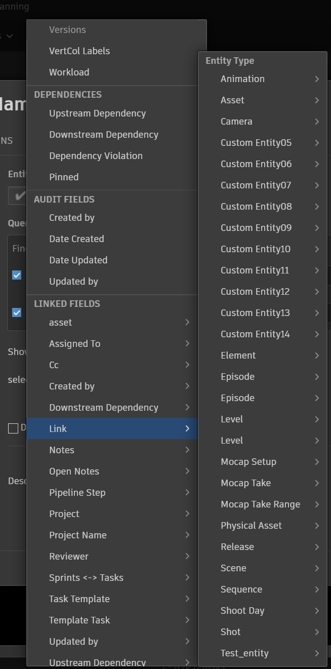

I can’t get Link>Concept Link it isn’t on the list without picking asset as a category

It’s a little tricky to tell from the info I see, but do you by chance have a field called “asset” and “link” on your tasks? If so, this could be causing your issue. Tasks will link to their parent, in this case and asset via the link field. Given this, your second image showing your query going to “Link>Asset>Concept Link” should work if that field is fully filled out on your assets.
Just a note about your query, it’s going to be pulling tasks based on the sort order field. Usually this is blank by default so you might find changing that to “date updated” or something else, if they aren’t blank that is
“I can’t get Link>Concept Link it isn’t on the list without picking asset as a category”
This makes sense and your second screenshot is what I was picturing/expecting to work.
