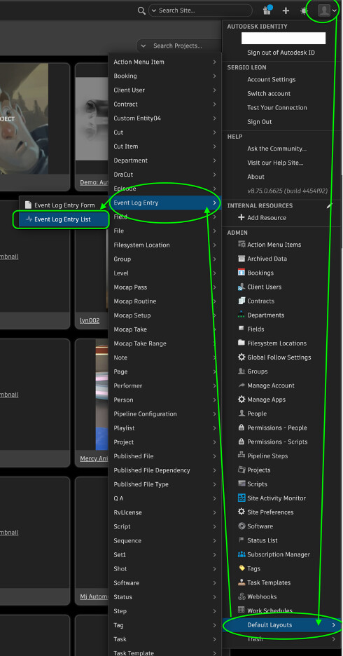

Events on the FPTr web UI
Events that have been registered in Flow Production Tracking (FPTr) can be listed on your site by checking the ‘Event Log Entry List’ from the default layouts.
Events are listed with their fields. Remember the list is paginated. On the right down corner you can set the list limit and browse throw the pages. The events fields will help us to understand in which context and from which tool were triggered. We will see they have the following fields or attributes:

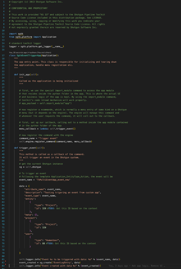

Triggering events
In case you develop your own application, engine or framework; or you need to make use of events for a specific process, you can create them. In case you are developing your own application, please follow the steps on this link:
One application that registers a command to trigger an event will look like this:
Note that the event that is being triggered is of the type ‘tkMultiEventApp_event_new’ following the format mentioned before. Some fields like the data and the user who creates it are automatically filled out by FPTR.
