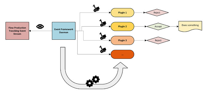

About the Event Framework
The framework is a daemon process that runs on a server and monitors the Flow Production Tracking event stream. When events are found, the daemon check the events out and react accordingly based on a series of registered plugins. Each plugin will be process according to the events they are following. This framework makes sure to separates well the monitoring of events with the logic of the processes they may trigger.
Pipeline engineers, IT, TDs or developers can focus on implementing the business logic in plugins that can be easily added to the framework. Your trigger Scripts can run independent of Flow Production Tracking. Alos your scripts can run from anywhere that has network access to the Flow Production Tracking server.
Remember the event framework will monitor the Event log entries we see in the ‘Event Log Page’. The history of events that are happening in a specific context.

You can see the Event framework daemon main loop in:
