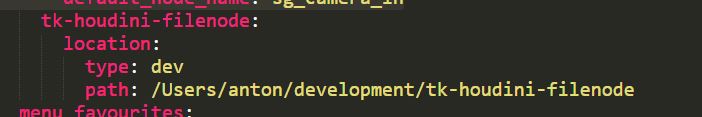

Ok little progress :D, tried to implement this one:
this time without errors…
like this: in (tk-houdini.yml)
the only thing is i can’t seem to figure out how to test it in Houdini since I am not sure how it works…

Freaking success!!! I added my firs node into houdini.
I am not sure if i done it right but it was this one:
      tk-houdini-geometrynode:
  location:
    type: dev
    path: /Users/anton/development/tk-houdini-geometrynode
  work_file_template: houdini_asset_work
  default_node_name: sg_geometry_out
  output_profiles:
  - name: Asset Work Cache
    settings: {}
    color: []
    output_cache_template: houdini_asset_work_geo_cache
    output_cache_shared_template: houdini_asset_work_geo_cache
I also had to edit the templates file…
