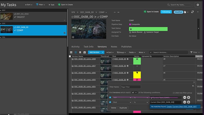

At our shop we have an “ingest” task where we add all our media. When artists open their tasks, they can’t see that media from their “comp” tasks.
Is there a one size fits all solution where we can maintain a separate task for ingest but allow artists to view that stuff on their my tasks?
Maybe it’s the wrong approach, what are others doing?
Thanks in advance.
I would maybe add to the above scrn shot a filter for just the comp (or rather current) and ingest pipe steps… But that would really really set us up for success.
@Ricardo_Musch curious to know what you think! :slightly_smiling_face:

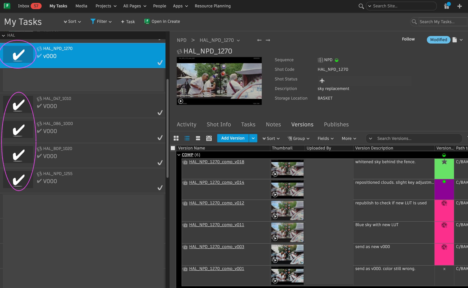

@PeteHart I wonder if you also know how best to populate these thumbnails now too :smiley: ?
You’ll need to configure the thumbnail field on the task entity for those. Let me know if you need more details around that
Thanks @PeteHart - do you mean programmatically? I wish there were a button somewhere, that’s what I’m hoping to find. Just basically make the thumbnails based on latest shot versions rather than specific tasks - or just any way I can add the “current shot” to the thumbnail query but doesn’t seem likely at the moment?

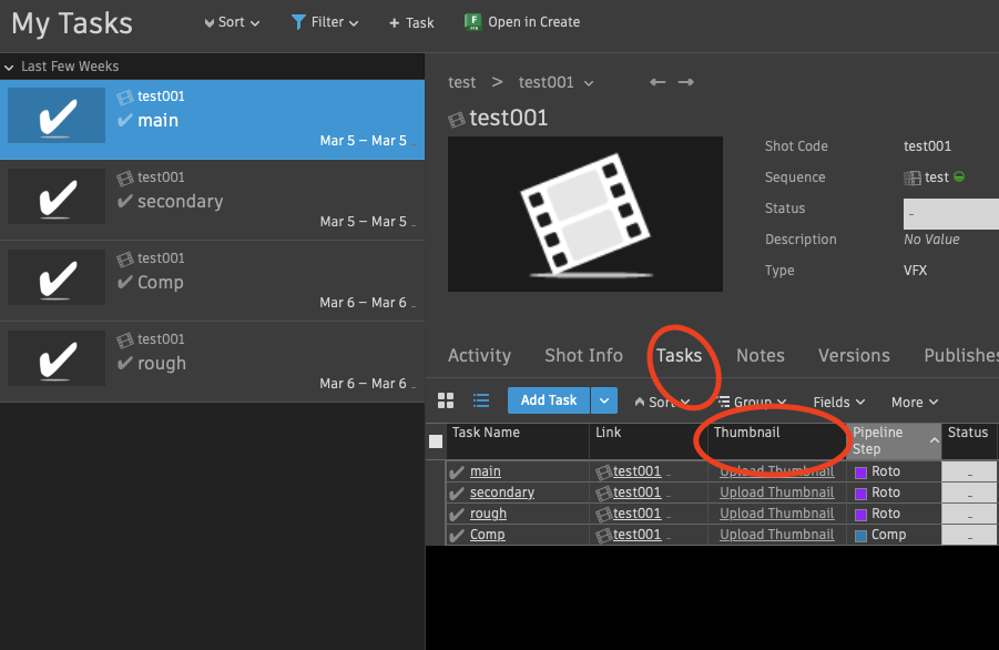

You can configure this in the site.

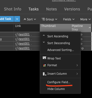

Select the tasks tab or go to the tasks page on your project and find the thumbnail field:
r-click on the header and hit “configure field”

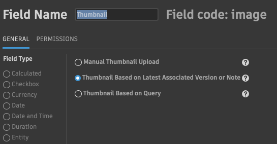

The default is usually the middle option, which is to use the thumbnail from the latest submitted version associated with the task (when someone publishes a version to the task it uses that thumbnail)
But you can use the “Thumbnail Based on Query” to set your own logic, or the top manual option to upload whatever image you like
ah yes thanks again @PeteHart - It looks like queries won’t let you find “current shot” at that level, and the second option only shows versions linked to the current task. In order for the task thumbs to show up with our Ingested plates (when no media yet available to replace), I’ll need to modify one of our ingest hooks to upload a thumbnail to the comp tasks. Issue with that is that I’d love for the task thumb to revert to one of the other settings later when there’s media on the task… Will not be easy I see…
