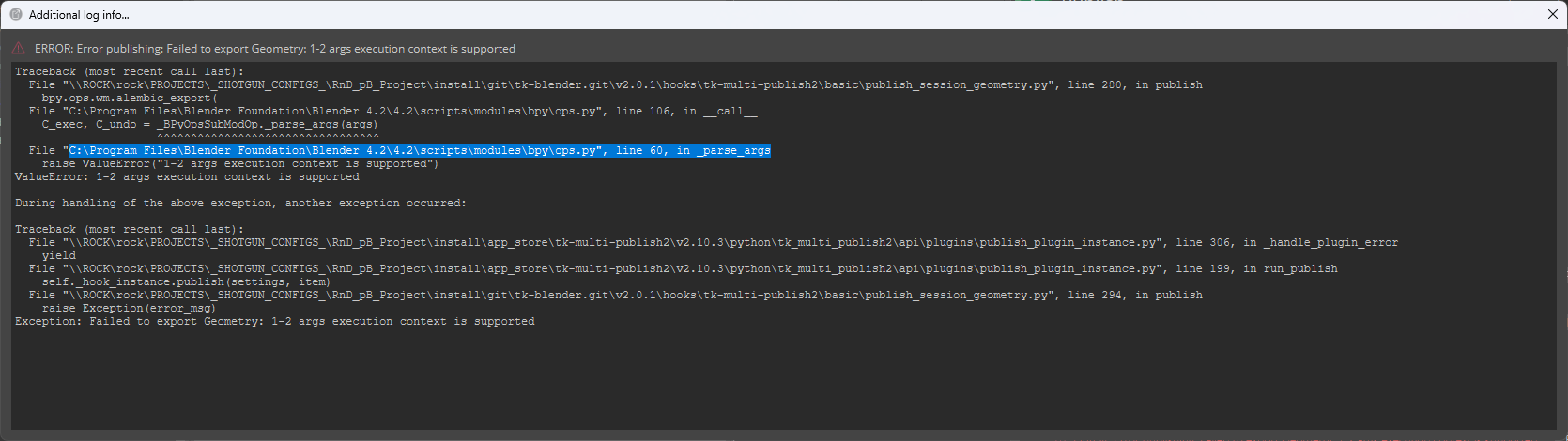

Hi guys,
I’ve just implemented TK-Blender on Blender 4.2 (v2.0.1). Thanks to GitHub - icentric-dev/tk-blender.
The Blender scene Management (Open/Save) feature with FPTR works well.
However, whenever I export or import a file, I run into issues with ops.py when I try to use Publish or Loader FPTR.
By publishing a Blender file with the All Session Geometry option selected, I receive an error regarding OPS (Failed to export Geometry). 1-2 args execution context is supported. Similarly, the same issue arises on the LOAD. FPTR when I try to import an FBX or ABC file.
It is weird.
Using the command lines below on the ShotGrid Loader doesn’t work, but it works perfectly if I apply the line directly to Blender.
import bpy
bpy.ops.import_scene.fbx(filepath="d:\Blender\RnDR_Jay-GEORIG_Rig_JayUE_v003.fbx", global_scale=1)
Does anyone have the same problem or know the solution to fix this problem?
Thanks,
Ricardo
Seems like it complains about the way you give your arguments?
Thanks @Ricardo_Musch
I didn’t change anything on the Publish; the commands are the default from the tk-blender GitHub downloaded.
I only tried adding a new Loader action manually to import the FBX, but I encountered a similar error. OPS Error
I think it’s because Blender needs a context when you use those main export functions.
There is no blender context when you use headless scripts or other python plugins like the Publisher or Loader.
(Context here is not to be confused with Toolkit contexts, it’s a way to tell blender what module of it to work on, i.e. the interface/viewport etc.)
Try this instead:
bpy.ops.wm.save_as_mainfile(filepath="/path/to/save.blend")
or if you need the selection:
bpy.ops.export_scene.obj('EXEC_DEFAULT', filepath=export_path, use_selection=True)
