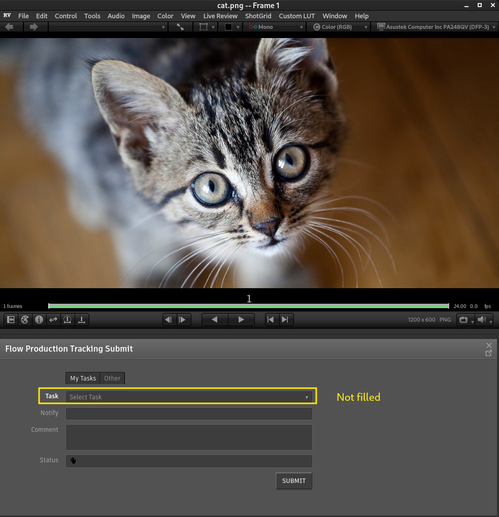

Not being a Mu specialist myself, I’m just trying to force a task to be set by default but it doesnt seem to work…
method: internalLaunchSubmitTool(void; [(string, string)] urlArgs = nil)
        deb("INFO: internalLaunchSubmitTool()\n");
        let defSession = getDefaultSessionFromSLUtils();
        _sessionUrl = if (defSession._0 eq nil) then "" else defSession._0;
        if ( _sessionUrl != "") {
            // this is an old function that changes the prefs
            shotgrid.theMode().setServerURLValue(_sessionUrl);
        // The url for the submit tool
        QUrl desiredUrl = QUrl("/page/review_app_submit");
        // Forcing Task for testing purposes
        let urlArgs = [("task_id", "413957"), ("project_id", "16199")];
        // Add the context query items to the url
        QUrlQuery desiredUrlQuery = QUrlQuery();
        for_each(urlArg; urlArgs) {
            print("DEBUG: %s,%s\n" % (urlArg._0, urlArg._1));
            desiredUrlQuery.addQueryItem(urlArg._0, urlArg._1);
        desiredUrl.setQuery(desiredUrlQuery);
I also added debug prints to see if my edits are really being picked up. I can confirm my changes are understood.
Am I missing something?
Hello @sbissonnette !
I tested it on my end as well and like you, I wasn’t able to prefill the Task. After investigation, it turns out that what is preventing this from working correctly is not on the RV end but on the Flow Production Tracking (Web) side of things. I will propose a fix to the Flow Production Tracking (Web) team to unlock this useful capability. I’ll keep you posted.
