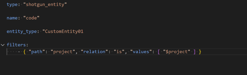

  • Using CustomEntity01
This tells Toolkit to create folders for every Level in this project.

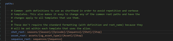

For all cases, it is important to review the keys and paths from the ‘Toolkit template definitions’. For instance, shot_root:
  • shot_root: seasons/{Season}/{Episode}/{Sequence}/{Shot}/{Step}
Also modify the wip locations depending on your DCC.

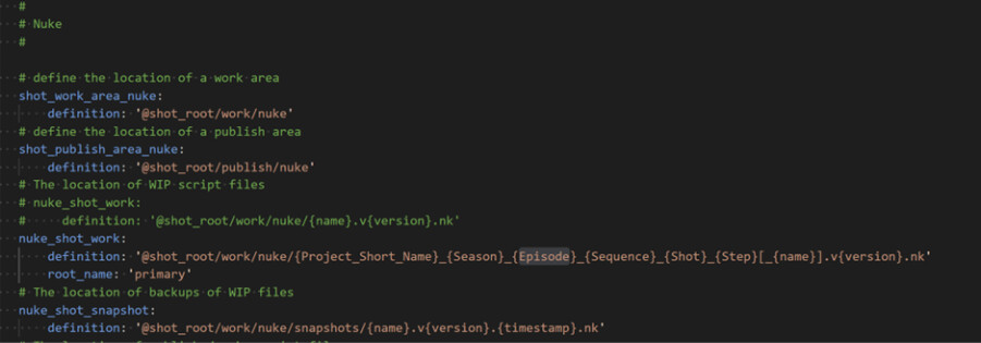

Step 13, 14, 15:
Edit the template to match the path in the file system schema

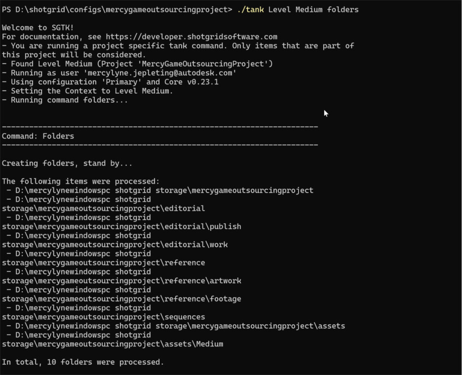

  • For Levels,
./tank Level Mylevel folders or ./tank Asset toy folders
You can then synchronize folders in order to have a clean folder creation process. Tank command to use is :
> ./tank synchronize_folders  -–full
