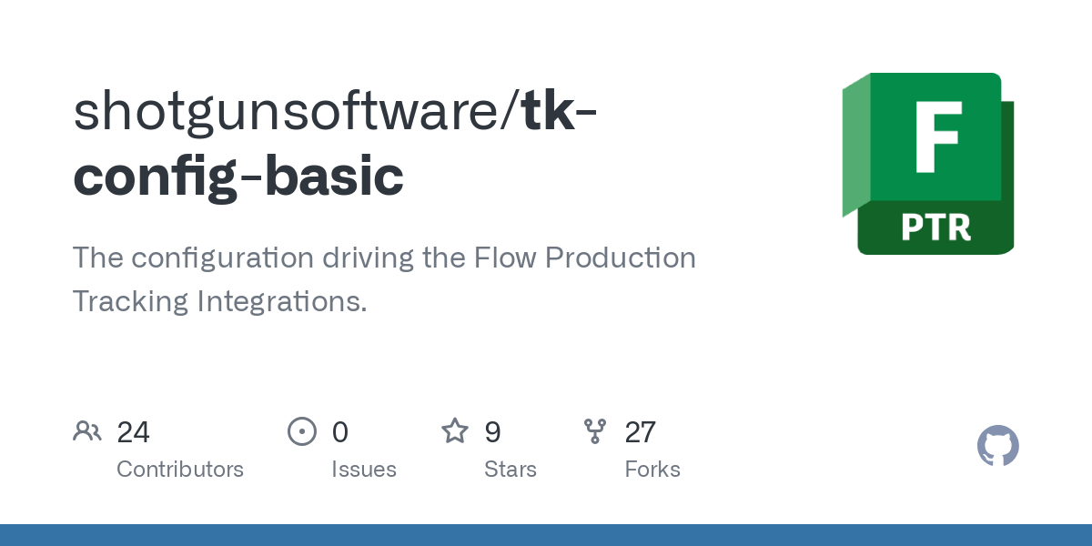

If you want to control the versioning of the frameworks like tk-desktopserver when Sg desktop boots up you need to fork the GitHub - shotgunsoftware/tk-config-basic: The configuration driving the Flow Production Tracking Integrations. and change it to your liking, then upload this to a new Pipeline Configuration on your site that has no Project link.
